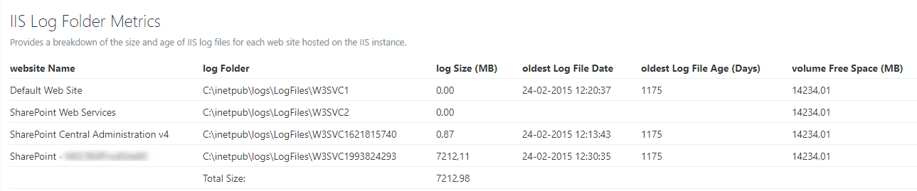

I needed to create a mechanism by which I could report on the amount of disk space being utilised by the IIS log folders, but I also needed it to be flexible enough to cover the differing number of websites that we see on our servers.
The resulting script, which I’ve named Get-IISLogFolderMetrics will enumerate the websites on the Server where it executes before building the path to where the log files exist. It will then gather further data such as the total size of the logs, the age of the oldest log file and the amount of free space on the volume on which the logs exist.
The above data is gathered for each of the websites on the Server before being returned in the required format. Typically for Data on Demand this is CSV and this is the default return type used if none is specified as a parameter.
The creation of the Task that utilises the attached Powershell script was made a lot simpler thanks to the Community Powershell Management Pack. I used this to define a new task with the name ‘List IIS Log File Metrics (Data On Demand)’ and provided the task name, a description and the script itself.
Once that was done it was incredibly easy to use SquaredUp to navigate to a Server which hosted an instance of the IIS product before choosing the IIS perspective. A couple of clicks later and I’d added a new ‘On-Demand Task (Grid)’ widget and populated it with the required configuration. I had considered going to the trouble of going through the configuration but it really was incredibly simple and it was just a case of choosing the appropriate Task from the drop-down list. Once done all instances of IIS would then report the relevant information as part of the perspective.

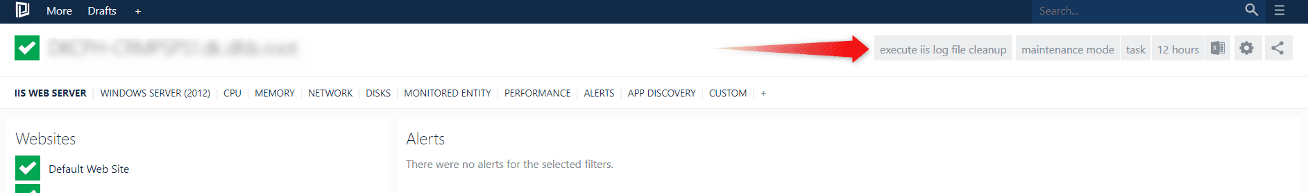

Again, the Community Powershell Management Pack made it easy to create the script, named Clean-IISLogFiles, as a task in SCOM. It was then simple to edit the IIS perspective in SquaredUp so that the Task could be created as an Action.
And that was really all there was to it. Now, when an IIS Server is viewed in SquaredUp we can select the IIS perspective to both view the amount of space being utilised by log files. And, if a cleanup is needed then we just click on the appropriate button at the top of the display.
Clicking the button executes the script and a summary is shown that gives a breakdown of the space that has been recovered by the process.
