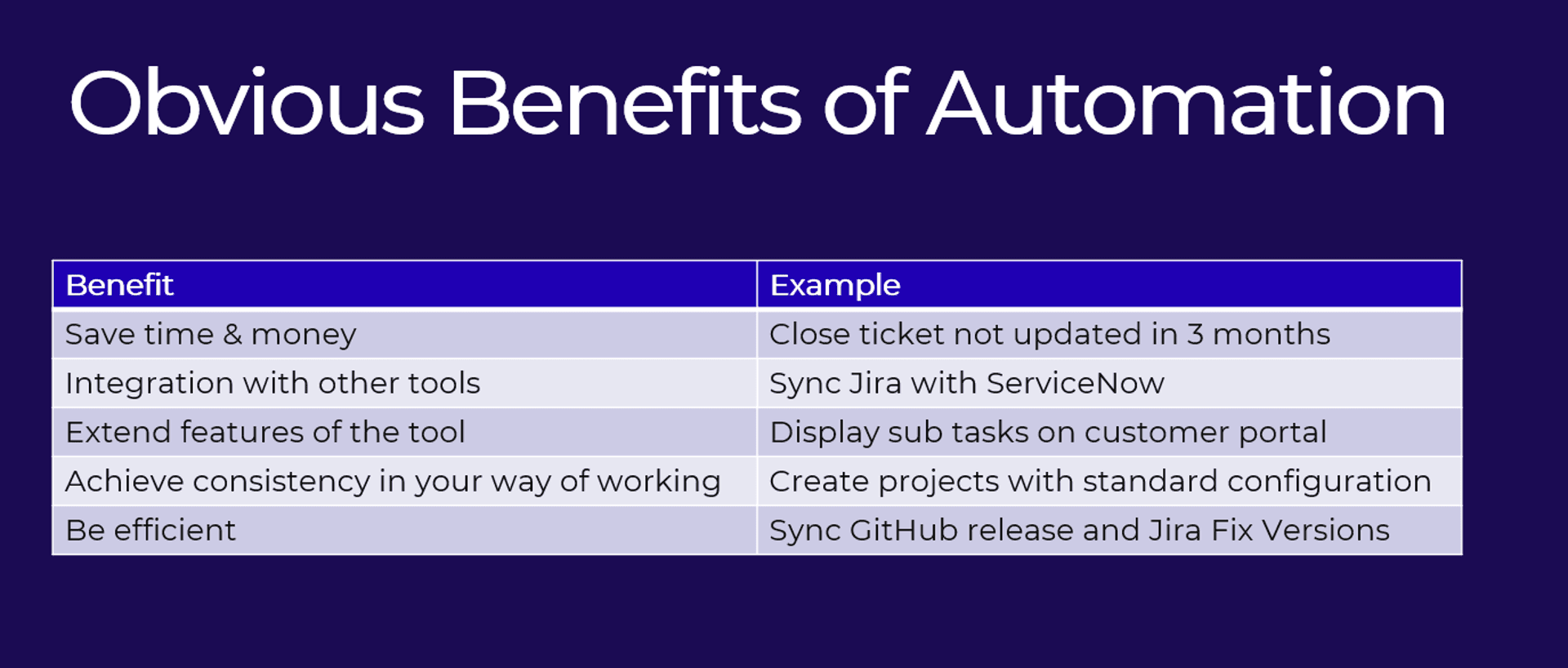

Here are some top line benefits and examples of specific use cases. Not only does it save time and cost, it also helps with integrations, and by extension, extending the features of your existing tools.

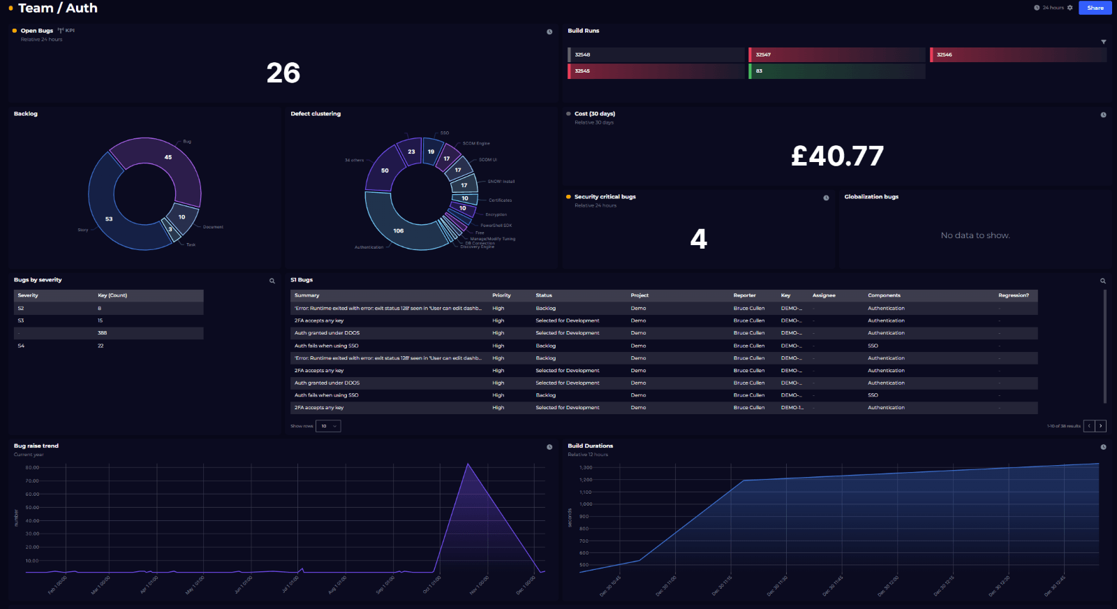

What if we told you that you could also automate your status updates? And that you can flow status and KPIs up to a single, aggregated view?
With SquaredUp, you can get full visibility across the projects, releases and issues from Jira, alongside all your other key developer data. Learn how.
Using SquaredUp, you can now:
