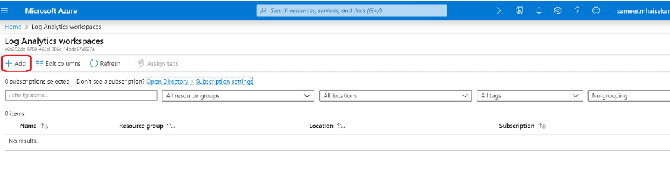

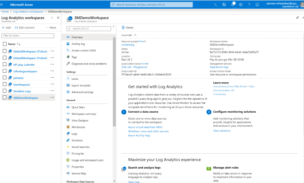

The first step to collect data is to set up a “Log Analytics workspace”. It is pretty quick and easy to do so:
Search for “Log Analytics workspaces” in the global search box.
This will open up a window displaying your existing workspaces. To create a new one, click on the “Add” button on the top.
Once done, you’ll be presented with your new workspace. You’ll notice a workspace has all the usual options that you’d expect to see for an Azure resource such as the activity log, access management, tags, locks, the option to export the resource as an ARM template, and so on.
There are also some resource-specific operations such as the summary, Logs, Service Map, and Workspace data sources. We’ll dive into these in detail in upcoming posts but for now, let’s talk about the data sources.

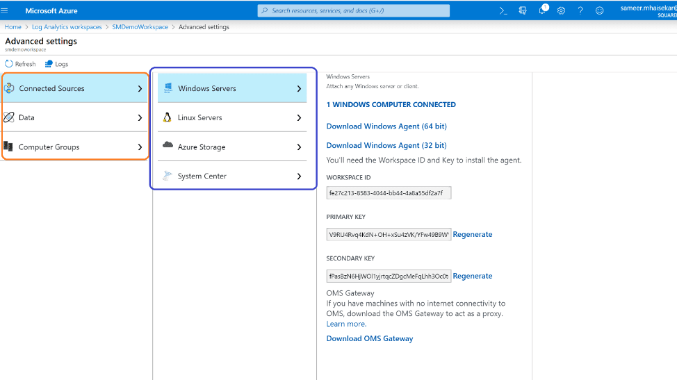

With your new workspace set up, you can now start ingesting data which you can then query using KQL. Navigate to “Advanced Settings” under the “Settings” section from the menu and you’ll be presented with these options:
The left-most blade, marked by orange shows you which sources you’ve connected (Connected Sources), and what data you are collecting from those sources (Data). The computer groups option lets you create a group of computers from sources like Azure AD, SCCM collections, etc. You can then use these groups to filter the results of your query.

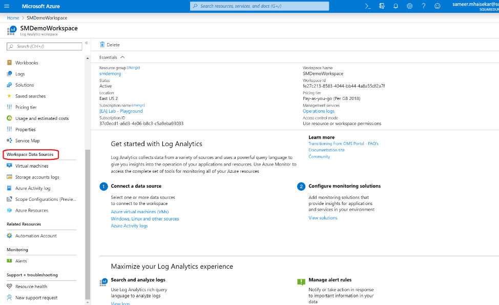

As you can see, I have one Windows Computer connected to this workspace. How did I do that? It’s fairly simple. Go back to the Workspace and look for “Workspace Data Sources”:

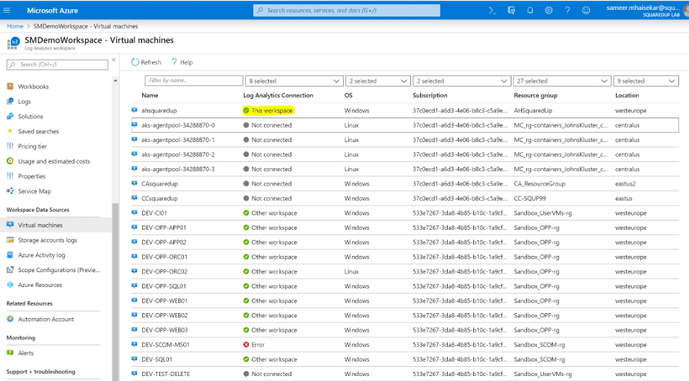

You’ll notice there are a few different data source types you can connect to your workspace, one of which is “Virtual Machines”:

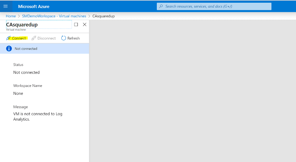

This blade will show you all of the virtual machines in your Azure tenant, and will indicate which Log Analytics workspace they’ve been connected to. You’ll notice that one of the VMs is connected to “This workspace”, some others are connected to other workspaces and some are not connected at all.

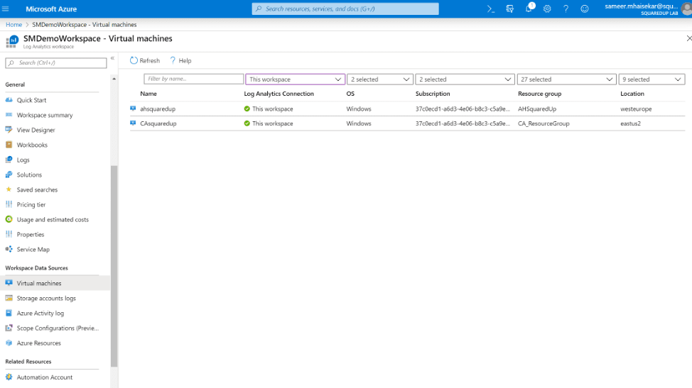

To connect a VM to a workspace, simply click on that VM and select “Connect”. In the background, the Log Analytics agent is being configured on your VM to send data to your new workspace. Note that the agent can only connect to one workspace at a time.
…and voila! You’ve now connected your VM to the workspace!

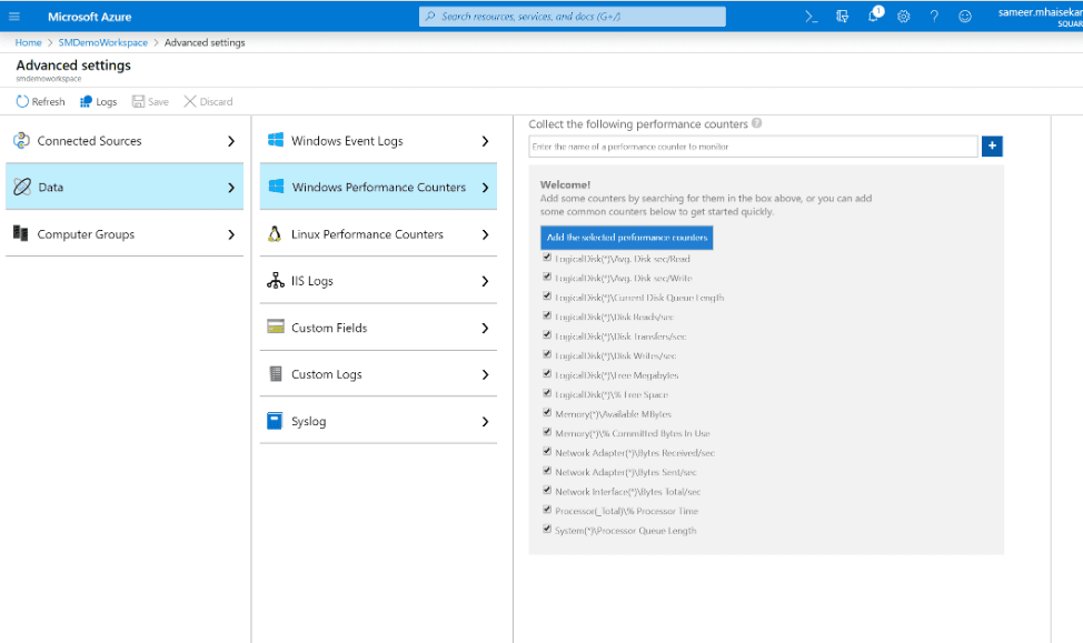

Once you’ve connected your VMs, you can now move on to choose what data you want to collect. Move back to the Advanced Settings and select “Data”:
As you’ve probably noticed, you can select different sources from within the VM to collect the data from, like the event logs, performance counters, IIS logs, Syslog, etc. The data you’re collecting this way, is stored as logs and is available to query. Read Microsoft's guide on data sources here.

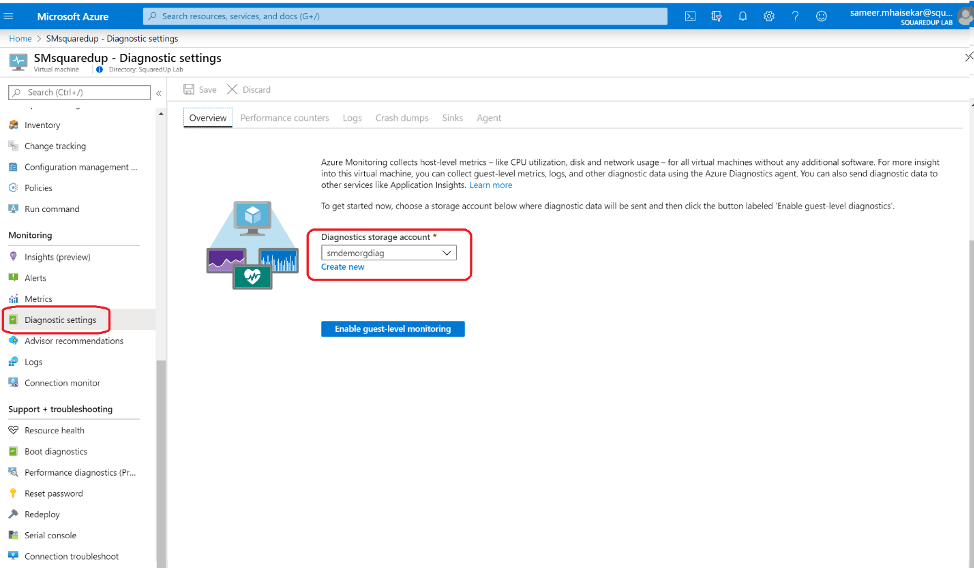

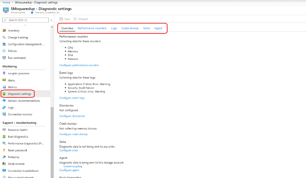

You can also collect some data into your storage accounts using the diagnostic settings. Diagnostics let you collect some platform logs and metrics, as well as some other important data such as sinks, crash dumps, etc. and store them into storage accounts, which you can then pour into your workspace.
Select the storage account and click on the “Enable guest-level monitoring” option to start collecting some guest-level monitoring data. It’ll take a minute to finish and another to start collecting the data.
Once done, you should see a bunch of options for the data that’s now available to you.
Important thing to remember here is this is only valid for the Azure resources and not the on-prem ones. For the on-prem resources, you need to install the Log Analytics agent on them (linked above).

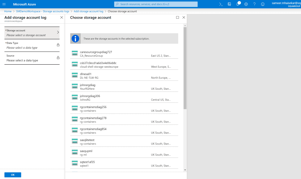

Now to connect this storage account to the workspace, from the “Workspace Data Sources” menu, choose “Storage accounts logs”:
Select the Storage account, the data type (IIS logs, events, Syslog, etc.) and you’re good to go!

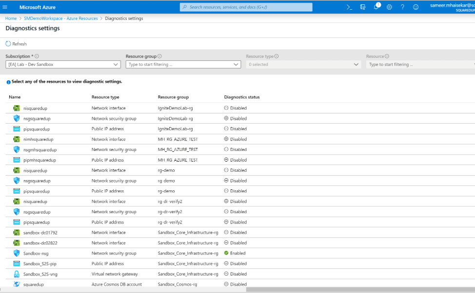

You can see which of your Azure resources have diagnostics enabled from the “Azure resources” view under “Workspace Data Sources”:

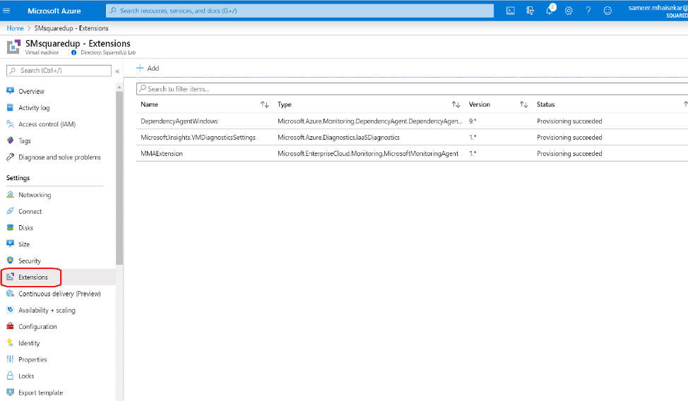

You can see what agents you’ve installed in your VM (diagnostics agent, log analytics agent, etc.) in the “Extensions” tab.
As you can see, we have the Diagnostics agent and the Log analytics agent installed on this VM. We also have a “dependency agent” installed on this, which is used for drawing Service maps. More on that later.

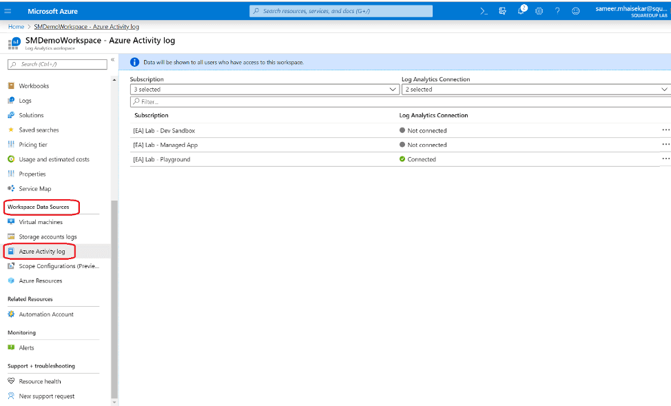

But that’s not all! Another type of really useful data you can collect is the “Activity Logs”. Activity logs record all the operations any users have performed against your Azure resources and are an excellent way to perform auditing. You can select the Activity logs you want to connect to the workspace based on subscription:
